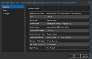

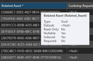

Sorry for the delay in getting back to you. I am actually using a GUID field type as well in my scenario on my related table. My feature class is utilizing a GlobalID field type and my table is utilizing a GUID field type (field is called 'Related_Asset') within the relationship class.
The association between the two fields happens in these lines where I am specifying the variable globalid as $feature.Related_Asset. The 'Related_Asset' field being the GUID field from the related table. The @globalid in the filter statement is being called upon against the feature class:
var globalid = $feature.Related_Asset
var filterStatement = 'globalid = @globalid'

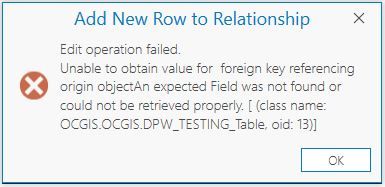

I apologize for the couple weeks' delay in responding.  I have been playing around with this today.  It is partially working.  I am able to get text to carry over when there is already a record in the related table which has a GUID value matching a GLOBALID value from the feature class.  However, when I attempt to 'add new to relationship' (new related record), I receive an error.  I have all 3 triggers set in the attribute rule.  Similarly, I get the same error when I attempt to remove a record from the relationship (although 'delete' oddly works fine).  When I use the script as a pop-up expression, it also works without issue; so, the problem lies when editing and trying to add a new record.
Thoughts about this?
Update: I closed out of Pro and went back in to try again.  Now I am no longer receiving the message above, rather I am receiving this message below.  "Field_B" is equivalent to the "Site_WH" from your example.  It's odd because the field that this error pertains to is the one that should be populated by the attribute rule...so it shouldn't even be able to be 'invalid'...
Terry_Bearb
Are you testing with a FGDB or SDE? I'm sure you've checked already, but regarding the invalid column value error, is there any sort of mismatch in field type or field properties between Field_B and the other field it is obtaining a value from? Or, any other attribute rules applied to the field?
ChristopherBowering
I am testing within SDE.  There are no other attribute rules in play and both fields are identical in properties (text, length 10).  I'm assuming the intended attribute rule is 'Immediate Calculation'.  As I mentioned, the code is doing what it's supposed to if the table record has a matching GUID value.  Even if I create a new record and manually paste in a corresponding GUID the Field_B will populate.  Can you confirm that it works for you upon adding a new related table record (when there isn't already a related record present for the corresponding feature)?  It's almost like it's trying to run the attribute rule prior to the record being generated instead of the other way around.
