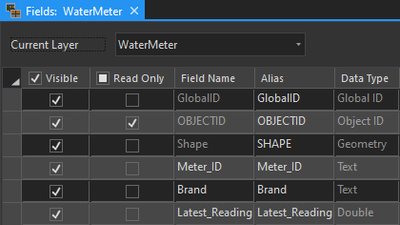

I built a rudimentary structure:
Feature class:
Table:
Relationship class:

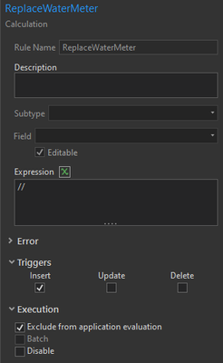

Attribute rule on the work table:
// Calculation Attribute Rule on WaterMeterWorkHistory
// Triggers: Insert
// Exclude from application evaluation
// Copies old values from water meter t
// get the water meter
var water_meter = First(FeatureSetByRelationshipName($feature, "WaterMeterTOWorkHistory"))
if(water_meter == null) { return }
// get attributes from water_meter
var old_attributes = {
  "Old_MeterID": water_meter.Meter_ID,
  "Old_Brand": water_meter.Brand,
  "Old_Reading": water_meter.Latest_Reading,
// map the attribute names from the work table to the feature class
var update_attribute_map = [
  ["New_MeterID", "Meter_ID"],
  ["New_Brand", "Brand"],
  ["New_Reading", "Latest_Reading"],
// if the new attributes are filled in, add them to the edit request
var updated_attributes = Dictionary()
for(var i in update_attribute_map) {
  var work_att = update_attribute_map[i][0]
  var asset_att = update_attribute_map[i][1]
  var new_att = $feature[work_att]
  var old_att = water_meter[asset_att]
  if(!IsEmpty(new_att)) {
    updated_attributes[asset_att] = new_att
var edit = [{"className": "WaterMeter", "updates": [{"globalID": water_meter.GlobalID, "attributes": updated_attributes}]}]
// return
return {
  "result": {"attributes": old_attributes},  // copy old attributes from water meter to work table
  "edit": edit                               // copy new attributes from work table to water meter
WaterMeter:
WaterMeterWorkHistory:
WaterMeter after these changes:
