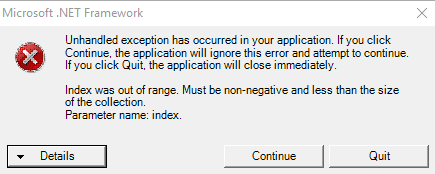

I am putting this in the bat file:
lmutil.exe lmstat -a -c @ip> ESRILicenseUse.txt
When I run, I get this .NET Exception:

The output text file, ESRILicenseUse.txt, yields:
lmutil - Copyright (C) 1989-2002 Globetrotter Software, Inc.
Flexible License Manager status on Wed 3/18/2020 15:06
[Detecting lmgrd processes...]
License server status: 27000@ip
    License file(s) on ip: C:\Program Files (x86)\ArcGIS\LicenseManager\bin\service.txt:
ip: license server UP v11.16
Vendor daemon status (on serverHostname):
License server status: 27001@localHostname
    License file(s) on localHostname: 27000@ip;27001@ip:
lmgrd is not running: Cannot connect to license server (-15,570)
Of course, I replaced the actual values of the ip, serverHostname, and localHostname for this post.

The issue I had was that the lmutil.exe that came with the attached zip download provided by Rebecca Strauch, GISP‌ was not the most recent (which makes sense, considering this post is from 2010).
In order to get the most recent lmutil.exe, I downloaded ArcGIS License Manager from My Esri to my local machine.
Check that the downloaded file matches the checksum provided by Esri to ensure the file downloaded correctly:
How To: How and when to use CheckSum (MD5)
Extract the files to C:\\users\<name>\Documents\License Manager 2019.2\LicenseManager\Setup.exe , and run the Setup.exe file.
This allowed me to get the most recent version of lmutil.exe:
C:\Program Files (x86)\ArcGIS\LicenseManager\bin\lmutil.exe
I copied and pasted that exe to the same directory as the downloaded program from Rebecca Strauch, GISP (Thank you Rebecca!!!), and it works!
