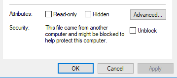

From the system you are having the issue with, open File Explorer to the external drive, right-click the mxd, gdb or folder containing the information and select Properties.  Look at the bottom of the dialog box under the General Tab to see if there is a security warning the files or folder is blocked because it is from another computer.  Just check the "Unblock" check-box and click Apply to clear.  See screen shot below.
VeraNeroni1
That does sound like it could be the issue. I just checked both the .mxd and the geodatabase, and neither seem to have a security warning at the bottom of the Properties window though. troubleshooting1.JPGtroubleshooting1.JPGTroubleshooting2.JPGTroubleshooting2.JPG
