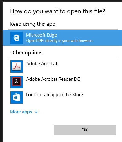

GeorgeKatsambas
This keeps on popping up, only with python in task scheduler?
