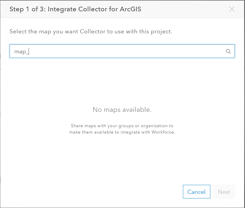

Hi guys,
I am having an headache with Workforce and Collector:
I created a project in Workforce and I want to enable the integration with collector. But when I try to add the map, the map I want to select isn't in the list. I logged out and in many times, even restarted the PC.
Other maps show as usual.
The map opens correctly in Collector and it is editable, though.
I checked every settings and it seems that everything is fine.
Any suggestion?
Thanks.

The list of maps is dictated by this rule:
The maps displayed are those supported by Collector that are shared with a group of which you are a member.
Tips for project owners—Workforce for ArcGIS | ArcGIS
My guess is there's a sharing issue - the web map might be shared with both the Organization and a Group.
Craig

PanGIS
Great Craig!
Thank you.
I had to log out and in again in order to see it but you made my day!
