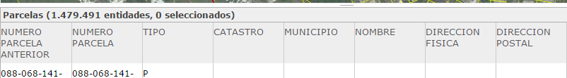

I already have a web map created in ArcGIS Online. I had to change the alias from the layer in the MXD and overwrite the service. The service now has the schema i need
but the webmap that is reading that service do not see the new changes in alias, it still have the old schema.

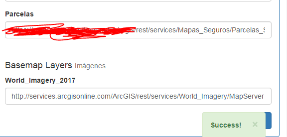

I change the url in AGO-ASSIST and it said it was success

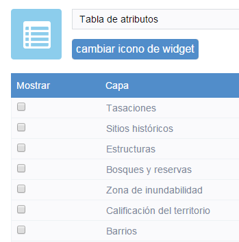

If I create a new web map and add the layer it sees the changes, the problem I have is that if i remove the parcel layer and add it again, for some reason my attribute table widget in WAB Dev remove my layer and even though i add it again using the same name and service it never add the layer again
If i want to have my Parcel layer again available in WAB DEV (And i need it, is the most important layer in my application) I need to recreate a new app all over again. So, my question is, is there a way that my layer already added to a web map in ARCGIS Online see the overwrite change of the parcel service?

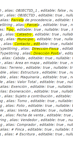

I notice i was not able to refresh the service in my Web Map so I had to change the Alias from Json file in ArcGIS Online Assistant.
I rewrite my alias here and I could see my changes in my Web Map.
