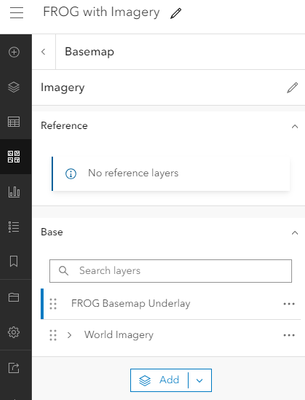

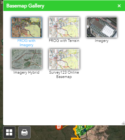

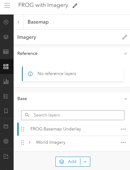

Hi All. I've just been made aware of an issue in one of our legacy Web AppBuilder maps in ArcGIS Online, and are looking for confirmation of others seeing the same behavior.

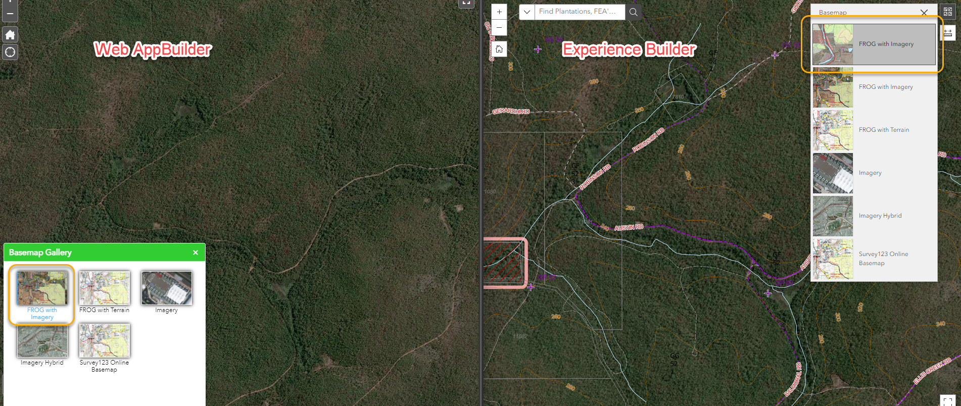

We have custom basemaps that use Esri's World Imagery as well as a Vector Tile Package overlay made available as Basemaps in the Basemap Gallery widget. In WebMaps, Field Maps and Experience Builder apps, these basemaps show up correctly when selected. However, it seems that after a recent update to our Vector Tile Packages, they no longer show up in Web AppBuilder apps.

I am seeing the same behavior. The official vector tile basemaps are working fine, but vector tile packages that I have published are not working at all. The web browser developer console isn't showing any clues, either, nothing happens when I select a basemap with a vector tile package layer.
millerjs2
I found this bug, looks like this may actually be a fairly recent regression if it was fixed in June 2024?
https://support.esri.com/en-us/bug/vector-tile-layers-do-not-work-in-the-web-appbuilder-fo-bug-00011...
