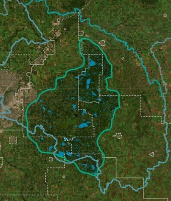

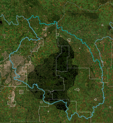

BHB_Admin
What is especially odd is that it is not converting every layer on the web app to greyscale, only some:
But again is completely fine on the online map:
