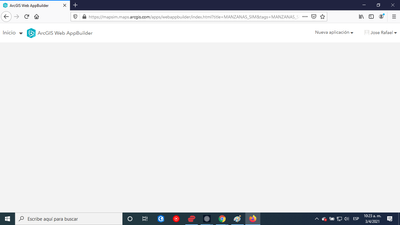

Hello Robert, I'm unable to use WAB. It just get stuck on this screen when I try to create a new app.
I already asked for help to the Esri represents that sell us the license in my country (Venezuela) but I have been waiting their answer for more than a month.
I got a Creator user and a GISPro Basic license, with any of those users I'm unable to use WAB.
I already tried with different browsers, eliminate cache, and enable pop up and cookies.
I hope you or someone in the Esri community can help me with this.
Thank you in advance.

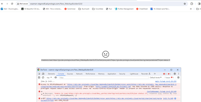

Hi all i'm new to ESRI Arcgis
I created the web app using the web app builder developer edition and i deploy on local windows IIS and hitting the URL  it throwing the Error of CORS Policy.Even i added the Access-Control-Allow-Origin:* header response could please anyone help me out what should i do.
Thanks in advance.
