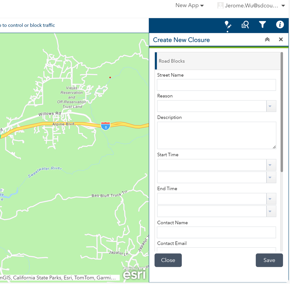

How do I edit the submission form for the Road Closure solution? I'm trying to edit the dropdown for Reason and add some new fields as well. The Smart Editor widget page doesn't seem to have that information. Any tips?Screenshot 2024-01-10 174814.png

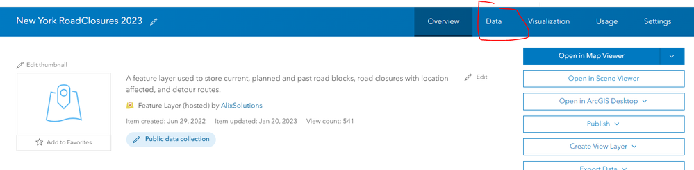

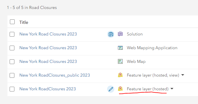

Hi @jerome6 , to add new fields to this layer and new domain values for the Reason field, you'll first need to find the hosted feature layer that was published when you deployed that Solution. For example:

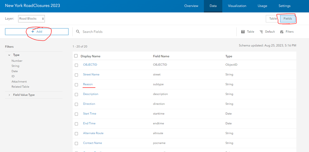

Access that's layer/s details page and go to the Data tab
From there you'll be able to add new fields and modify existing ones.

Thank you for your response! I'm trying to save my edits in the Fields tab but it seems to be stuck on save and eventually fails to save altogether. Any suggestions?
