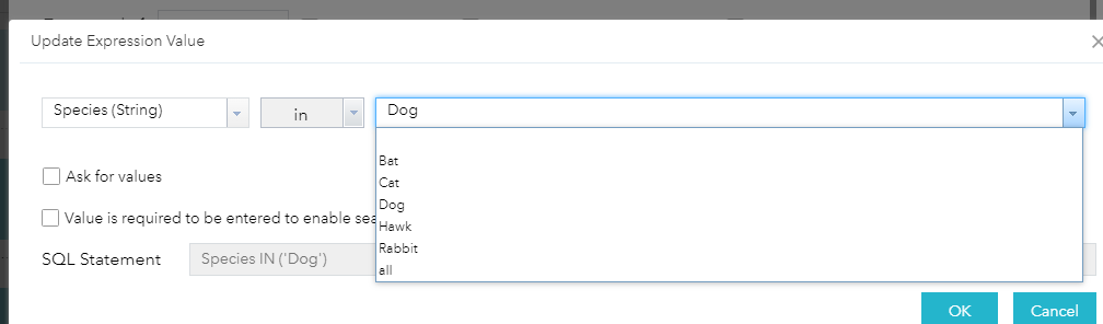

rocioveloz
Hi Mr Scheitlin.
when trying to configure the enhanced search so our users can search by choosing from a dropdown: i am trying to figure out how and where to type in those comma-separated-values you mention above....
Once i go to edit the expression in Update Expression Value, how can I get the search to list all the animal options on a dropdown? thanks in advance for any help.
RobertScheitlin__GISP
MVP Emeritus
Rocio,
   When using the eSearch widget after it has been configured to use IN and value (not predefined, as that will just be a list to select from). Then you can type the comma seperated values in the textbox.
