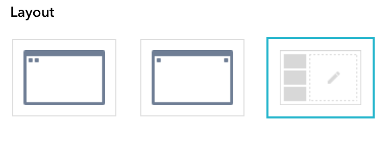

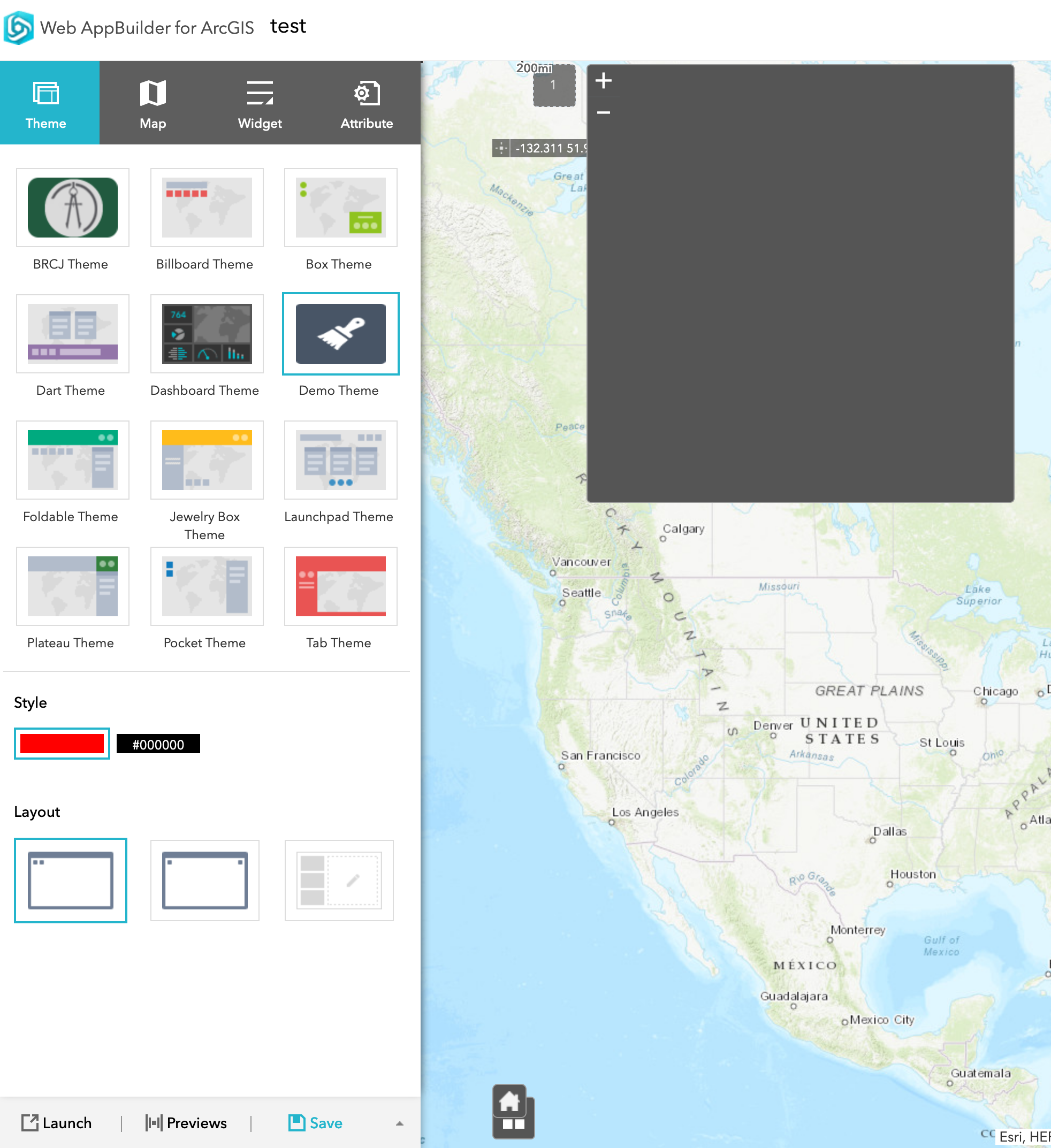

I have previously cleared out the .repoignore file. I can see the demo theme within WAB. When selected it lists 3 layouts
When a different layout is selected the on screen widgets go out of whack. The controller widget is still not being loaded.
Brad,
Hmm. Strange. You should not have three layouts in the demo theme if you are following the tutorial...
