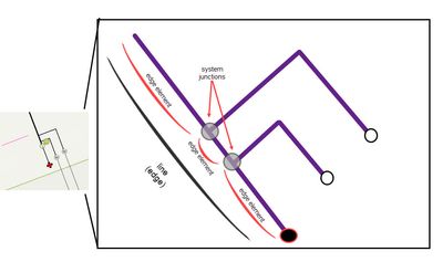

When you have an edge (line) connected to another edge midspan, as long as they share the same AG/AT the same principle applies because we are focused on edge elements instead of the line (edge) feature itself. In scenario 1 and 3, a system junction is placed (hidden) midspan on the line, updating the line to be composed of multiple edge elements.  So, in this scenario the two edge elements share the same endpoint.
For connectivity to be established midspan in the first place you need to ensure the line feature supports midspan connectivity by setting the edge connectivity policy for the AG/AT.
A picture using your example 3 might explain it better:

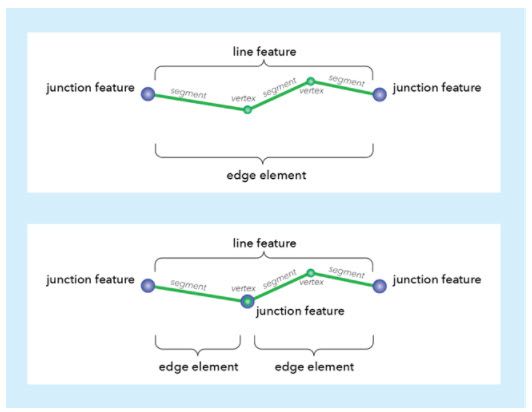

Another way of looking at it.  When a line in the utility network has another feature connected midspan, it creates another edge element for the line.  Edge elements compose the logical component of edge (or line) features in a utility network. A complex edge (which all UN line features are)... is a feature is associated with a set of junction and edge elements in the logical network.
