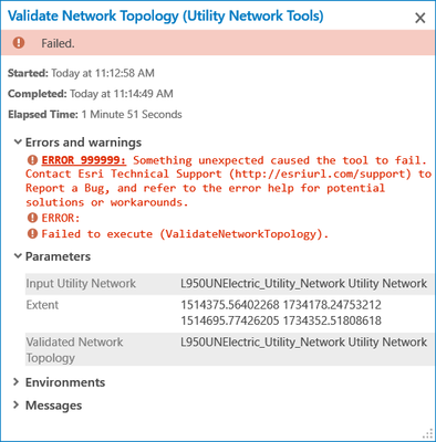

When validating my network topology on dirty areas it fails with a very generic error message.  I tried it through the GP tool and get
and if I just try it the data tab across the top of Pro I get either one of these.
I just created this Utility network and getting this from the begining.  I am getting this message in default and in child version.  I'm running Pro 2.6.3 and Server 10.8.1

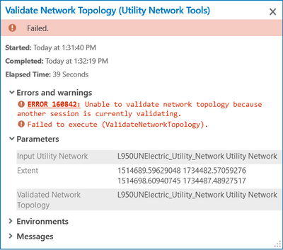

I followed same steps and still get same error though not as consistently as before. First edit Validated correctly. After that it comes with inconsistent "Edit Operation Failed. ERROR" using Pro menu and "Error-999999 Contact Esri" using GP Tool.
One time, the validate process timed out and now getting "another session is validating" error.
