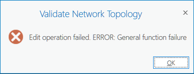

When validating my network topology on dirty areas it fails with a very generic error message.  I tried it through the GP tool and get

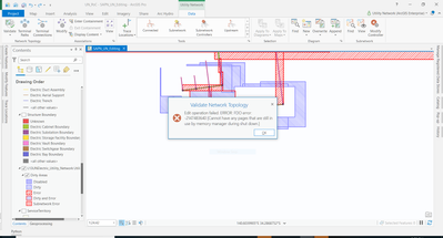

and if I just try it the data tab across the top of Pro I get either one of these.
I just created this Utility network and getting this from the begining.  I am getting this message in default and in child version.  I'm running Pro 2.6.3 and Server 10.8.1

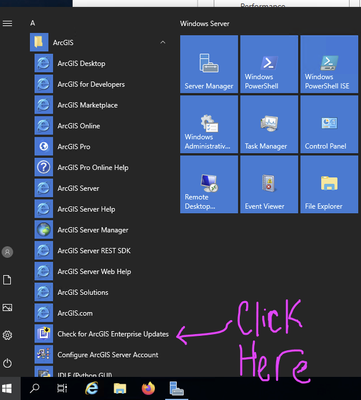

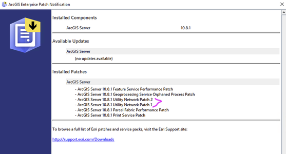

You can get all the patches available to ArcGis Server going to the machine running it, click the windows icon and  go to the ArcGis folder. There you will find an application (Check for ArcGis Enterprise Updates) that lists all the patches available for your version of ArcGis Server/Enterprise.
On 12/29/2020, Esri released a second patch for ArcGis Server 10.8.1 Utility Network. Check the pictures below.

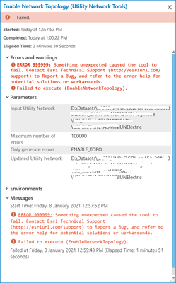

I recently upgraded my ArcGIS Pro to 2.6.2 and ArcGIS Enterprise to 10.8.1 and I am now having exact same issue as @LindseyStone . Any edits or creates and I cannot run validation after using tool or Pro command. I tried to install 10.8.1 Patch 1 for UN. But after this patch, I consistently get error Enabling Topology as below. I have tried machine reboot, ArcGIS Enterprise restart etc.

And I get this error sometimes
