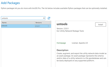

After cloning the default Python environment (and re-starting ArcGIS Pro), in the Python Package Manger, I attempted to install UNTOOLS 2.5.
The installation run without errors; however, after re-opening ArcGIS Pro, I could not see the Utility Network Package Tools toobox in the Catalog window:

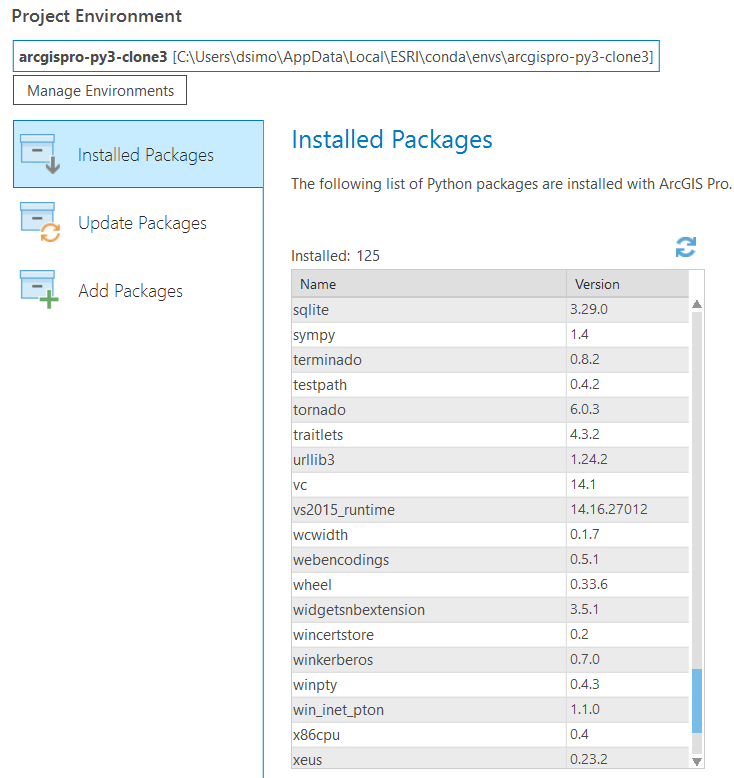

In addition to that, UNTOOLS 2.5. does not appear in the Installed Packages list:
