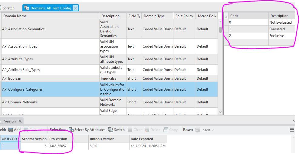

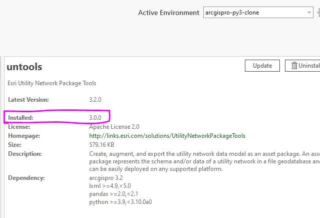

This is so confusing. I have ArcGIS Pro 3.0.3 with untools package 3.0.0 currently installed in my py3-clone active environment
After exporting any utility network to an Asset Package (which shows as Schema Version 3) I'm expecting to see the newer configuration categories ("AP_Configuration_Categories" domain values) per the 2.9 release notes.
3: Remove when applied.
4: Always remove when applied
5: Keep when applied
6: Always keep when applied
If I'm already beyond the released version, what happened? Why don't newer versions of untools have these codes that were already added in previous releases? I need to have all these options for testing D_Configuration and removing items. Must I upgrade Pro? I don't think I'll be able to install a higher version of untools until my Pro is upgraded. The problem is that we have an organization standard for Pro, so I'm hesitating on going this route unless absolutely necessary.

untools 2.9.5 was released 2023-01-19 (config states 3 & 4)
untools 2.9.6 was released 2023-03-03 (config states 5 & 6)
untools 3.0.0 was released 2022-06-23
Pro 3.0 is not a Network Management Release, which is why there is only untools 3.0.0
