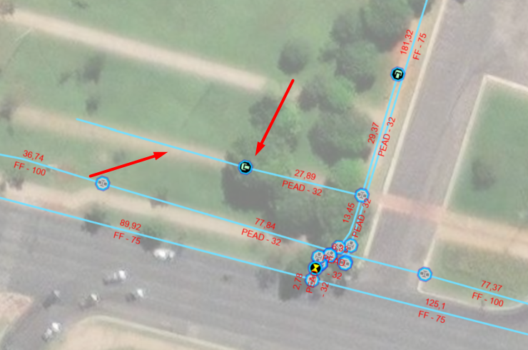

How can I configure a network rule that can possibility to connect a feature in a one line, and, when I connect in a two lines, returned a dirty area, I think about (Junction-Edge Connectivity), but, when I connect other line in the point, I doesn't have a error.
We have somes situations where we need to connect a point just in a end point/vertex.
Example: End Cap, we need to connect in a just one line, because this is a feature that connect in a end vertex.

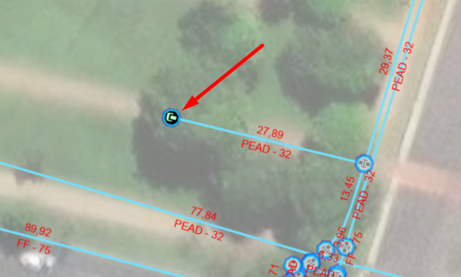

This picture, we can see a End Cap connected in just one line, and, we doesn't have dirty area.
And, in this other picture, I create other line that connect in a End Cap, and, we doesn't have dirty area too.
I need a rule that returned error when I connect some features in two lines.

Unfortunately, junction edge rules only determine which features are allowed to connect but don't control the cardinality of the features that are allowed to connect. To do something like that you'd need to write something like a validation attribute rule to enforce the cardinality of connected lines.
