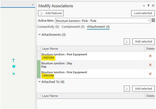

One of our workflows, when setting associations, users will typically do a broader select to update associations, trusting the system to make the appropriate selection, based on our configured rules, then review and apply.  In AGP2.7.4 this can handle where an association already exists and only apply the changes.  In AGP3.2 (and proven back in AGP2.9) users receive an error if an association already exists, and the modify associations pane shows the  duplicate entry (shown below)

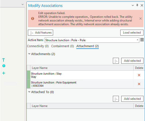

User receives an error message when pressing apply.  This error remains until the user removes the duplicate record.
