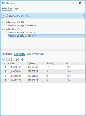

I'm having trouble getting my subnetwork to have isConnected turned to true.  It is the first subnetwork I have created.  There is a Medium Voltage Circuit Breaker that controls a circuit we call circuit 93.  I have made the circuit breaker into a subnetwork controller in the Distribution Tier. I don;t understand why i can't populate Isconnected downstream.  Somehow I seem to have populate the BUsbar upstream to connected.
Can someone please look at the attached gdb and help?

The real problem is that your distribution circuit isn't able to make it past your first length of conductor because the second conductor is not connected to the attachment. I noticed there were a lot of dirty areas in the network, and after disabling the network topology and enabling the network topology the subnetwork appears to trace correctly (according to the data you have provided).

Did you edit the second conductor to snap to an attachment?
RobertKrisher
I did have to manually snap it. It looks like you have made adjustments to the z values of some of these geometries. The Z of the attachment and the first line is 0 (which is why they're connected), but the first vertex of the next line has a Z value of -1.
BryanMay531

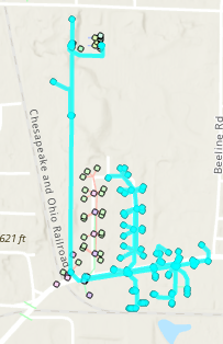

I changed that z-value back to 0, snapped the line end and its tracing now.  thankYou!
