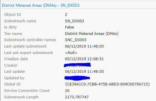

1. Subnetwork details before editing

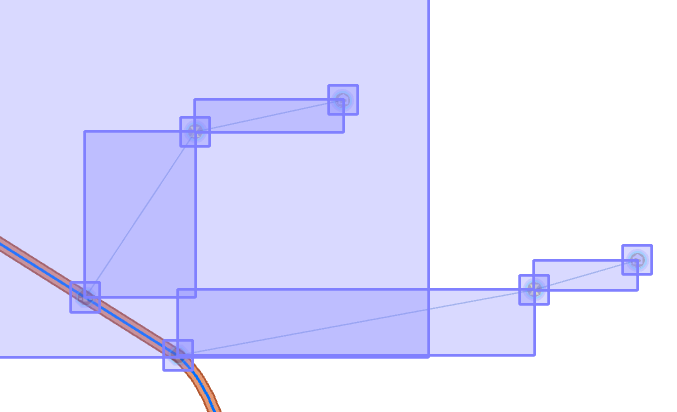

2. Added in a couple of new service connections
Added in service connections
3. Validated the network topology to clean dirty areas
4. Tried to run the Update Subnetwork tool for that specific subnetwork but it is not listed in the tool dialogue and the IsDirty attribute is still set to False

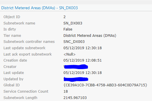

6. Run the update subnetwork tool and see updated details on the subnetwork e.g. increase in service connections and total length and last updated date.
Updated subnetwork details
