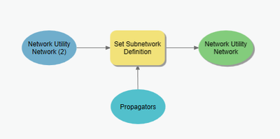

  1. Open Modelbuilder in Pro
  2. Drag and Drop the Set Subnetwork Definition tool within it
  3. double click the tool and select your utility network

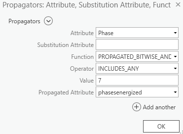

  4. right-click the now coloured tool and navigate to Create Variable -> from parameter -> Propagator
  5. double click it and select the network attribute you created and assigned to the phase field
    1. sometimes here I have to re-open the propagator to get all the values to populate correctly
  7. Run the tool
  8. Verify in the network properties that it exists.
In the end, your model will end up something like this:
