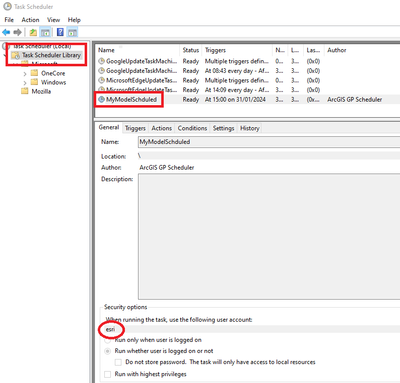

Hello @kadhav  , I think you should check in Windows Task Scheduler to see the User Account who running the model. It may be that they don't have permission to access the location you have specified, so it uses a default instead.
