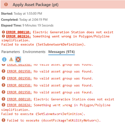

DasheEbra
Hi @PaulLeBlanc1
I face related Issue while using Apply Asset Package:
A.Messages
ArcGIS Pro 2.9.2.32739
untools 2.9.1
Executing from ArcGIS Pro, 2 map(s), activeMap = True
Parallel processing enabled: 6
Asset Package schema version: 2.4
B.Erros:
ERROR 000110: Electric Generation Station does not exist
ERROR 002824: Something went wrong in Polygon/Polyline simplification.
Failed to execute (SetSubnetworkDefinition).
ERROR 001958: No valid asset group was found.
WARNING 000952: Failed to execute (AssignDomainToField).
My environment:
Pro 2.9.2
Enterprise: 10.9.1
PostgreSQL DB
RehabAhmadRaihanChowdhury
I'm having the exact same issue.
FernandoFormagini
Same errors here, v3.1, using data from ESRI Water Management Tutorial...
