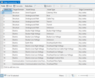

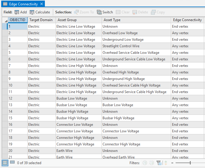

Record counts in the B_EdgeConnectivity table before applying the Asset Package to the Enterprise Geodatabase (Total of 39 records in the table)

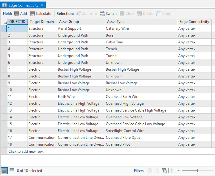

Record counts in the B_EdgeConnectivity table after Exporting the Utility Network to an Asset Package (Total of 18 records in the table)

The default value for a line is End Vertex.  On export, these are filtered out as the asset package does not need to maintain the value of the line if it is the default value.
