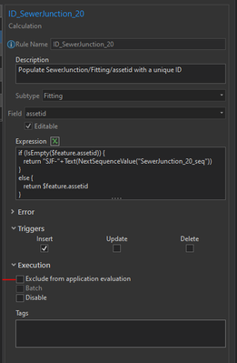

I looked closer at the sewer attribute rules and they need this checkbox enabled:

I will give that a try.  Can you explain what that check mark is and what it does and was it a bug somewhere that that wasn't automatically checked?  I brought this all over.  I didn't modify any rules from the default ESRI Sewer Asset Package.

From the GP help:
Specifies whether the rule will be excluded from evaluation before edits are applied. Because not all clients may have the capability to run all of the available rules, you can choose to flag a rule for simple clients only. For example, some rules may refer to data that has not been made available to all clients....
In this case, the client (Pro) does not have the context of the database sequence because it lives in your enterprise geodatabase, which is being accessed from services.
This page also has some more info.
We will update the data models and geoprocessing tool to enforce this. Thanks for reporting!

Checking the Exclude from application evaluation on all of the assetID rules did the trick.  I'm still curious to know what the setting actually does and if it needs to be checked on any of the other rules within the Sewer Network or if there is some sort of documentation that has that information in it.
