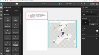

I have tried do it on the experience builder developers edition. After publishing the web map with Utility Network & trace configuration, I've add it to the app and tried to link the trace widget to the map, it seems like It does not recognize my network?
I have previously followed this guide to upload my other utility network, is this no longer a valid method?

@YiuTungNicholasTse , when creating the web map, were you able to follow the steps as described in this blog? Configure an Application to Trace a Utility Network (esri.com) - in summary:
  1. make sure the utility network features service is added to your map in ArcGIS Pro
  2. sign in to your target organization (if not already)
  3. share the trace configurations as active for the map
  4. and finally share the web map to your target org
Note that the utility network feature service should not be shared for public access - a login prompt is required and the user account that logs in needs to have the ArcGIS Utility Network user type extension assigned.
YiuTungNicholasTse
Thank you for your support @AlixVezina! I have found out the reason why it did not recognize the utility network.
Apparently I was uploading the webmap with the wrong source (the UN within the enterprise connection SDE). I wasn't aware that the tool requires uploading the webmap  from the previously uploaded UN feature service stored in my portal. Once sharing webmap with trace config with the right source, the tracing tool recognizes my UN.
