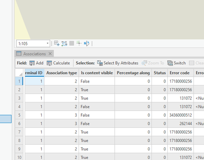

No issue with those being empty.  Just means you did not load any data.  But without records in there, not sure how you got an object error.  My last guess is that a feature has a containment association, but the parent container has been deleted.
If you add the Associations table to the map, we can look for any associations with errors.  Download the UDMS tool and use the Create Utility Network System Tables View tool.  Look for any records with error codes -
BugPie
Thanks for the suggestion! I'll be able to give this a whack later this week and will reply once I get some time to try. Thanks for your help Mike Miller.
