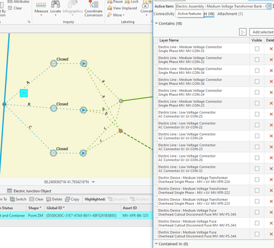

I have been exploring the ElectricUNFoundation project and came across your comment regarding the JunctionObject in the electric industry. I would like to understand its benefits better. From what I gather, the project includes the following components:
  1. MV Transformer Bank: This is an assembly that contains multiple devices, typically three transformers as shown in the example screen.
  2. MV Transformer Device: These devices are contained within the transformer bank or assembly.
  3. MV Transformer JunctionObject: This object is associated with the transformer device.

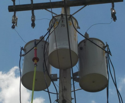

and based on my knowledge If we take the Transformer Bank as an example, usually the transformer banks contains multiple transformers (often3 transformers) as appeared in the following screen:
Based on my understanding, when we model a transformer bank, we typically represent it on the map by adding Assembly point (transformer bank for example) then adding three devices (transformers) as content within this assembly. Each device has its own terminals, eliminating the need for a separate table to define terminals or ports if we would like to know which port/terminal connected with another port/terminal or another Line.
Considering this, I'm having difficulty grasping the benefits of the JunctionObject. Could you provide further clarification or examples to help me better understand its purpose?

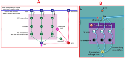

With this new understanding, it appears that both methods of modeling the taps on the cable are valid as appears in the following screen. In method A, we can have three taps geometrically connected to the line, with each tap having its own phases. Alternatively, in method B, we can use a single tap associated with three JunctionObjects, where each JunctionObject represents a phase, and each JunctionObject is connected to a single fuse. And as you mentioned method A (3 spatial taps) is most recommended to be included in the JSON file.
If I've understood correctly, these are the two valid approaches for modeling and managing JunctionObjects. Please let me know if I've interpreted it accurately or if there are any additional considerations I should keep in mind.
RobertKrisher
It's not quite so clear cut, I recommend you spend time looking at the area I mentioned in the Electric Utility Network Foundation for examples. The two approaches you outlined above are both equally valid using the assembly/device approach. Example B looks like it would work for non-spatial objects, but based on the style of the diagram I don't think that is what is being depicted (it looks like documentation from the assembly/device model).
