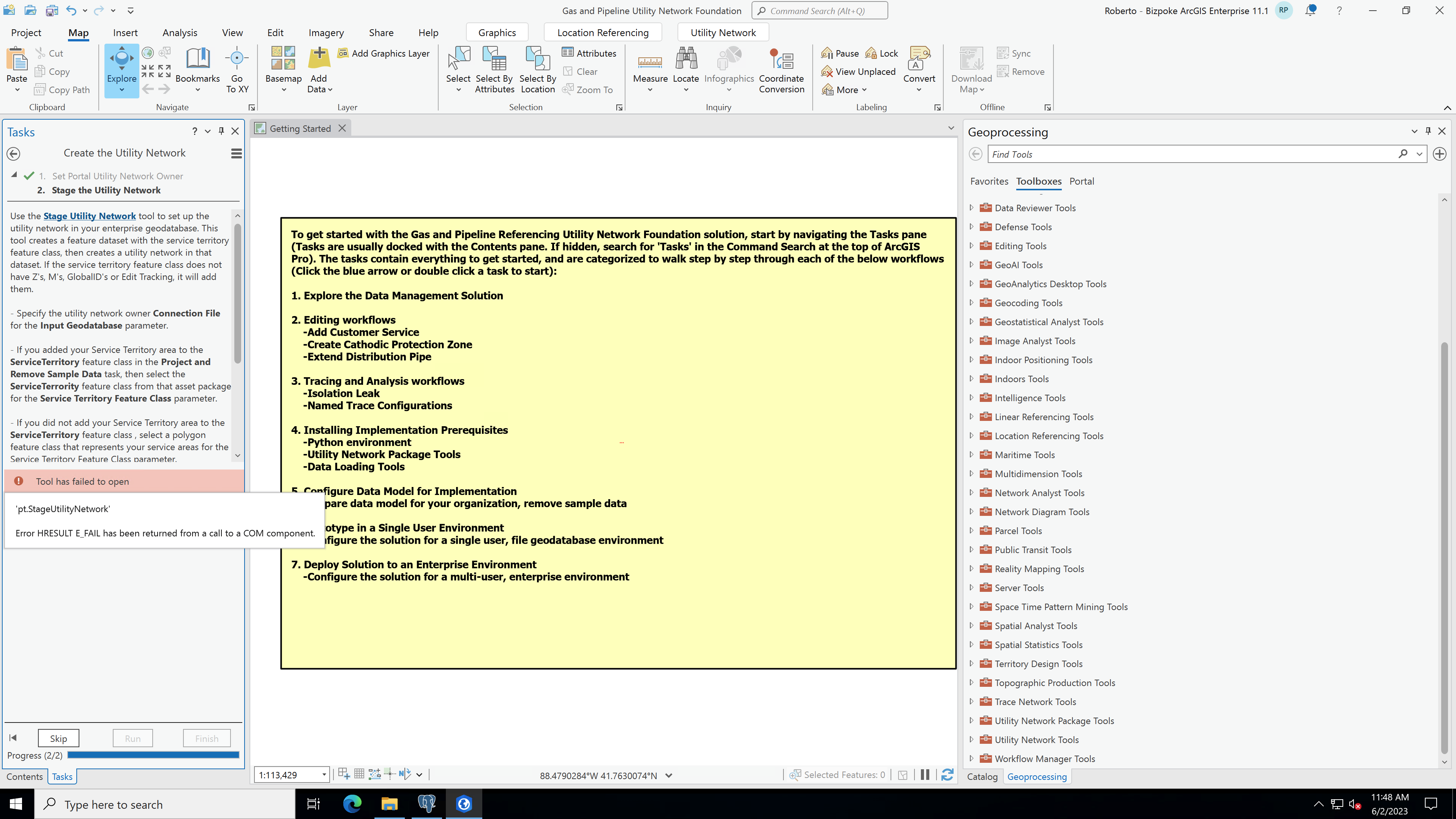

After my ArcGIS Pro upgrade to version 3.1.2 this morning, the Stage Utility Network geoprocessing tool from Utility Network Package Tools sometimes fails to load.
If I restart Pro several times, it will eventually load and work properly. You can see an example of how it fails in the screenshot attached to this message (this was while working towards implementing the UN Foundations for Gas and Pipeline, latest version).

Hi @RobertKrisher ,
Thanks for getting involved. Trying to load the geoprocessing also fails with the same message, but only when the task step fails. In short: when it works, both of them work and when it doesn't work, both fail (I'm experiencing this behavior only in 3.1.2).

I don't. I also tried to execute the GP on a blank project and saw the same results, but not every time (as I mentioned before, if I repeat the process a couple of times, it eventually works).
I think I (accidentally) found the root cause of this issue, although I still can't explain why it was happening. I have two portal connections configured on this ArcGIS Pro. Last week, I needed to change the active portal connection. After the work was done, I changed the active connection back to the original one and haven't seen the error since then.
