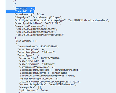

I'm trying to add associations with a REST call and got stuck when trying to identify the 'networksourceid' in the TO/FROM attributes of body.  I'm hoping there is either a table of ids I can reference or that this is identified somewhere else.
When I reviewed previous association adds and deletes, the networksourceid I saw in the calls didn't line up with expectations.  Meaning, I expected the ids to be the same as the layer index in the feature service.  They are not.

You can call `queryDataElement` rest call on the feature service and provide the utility network layer id.
https://server.esri.com/server/rest/services/service_name/FeatureServer/queryDataElements
[13] is the utility network layer id
You can find the utility network layer id  querying the feature service definition and looking up utilityNetworkdatasetId "controllerDatasetLayers": {
"utilityNetworkLayerId": 13

The utilitynetwork layer id will be different for each feature service. You can find the utility network layer id dynamically for any feature service (if it exists) by querying the feature service definition.

@HusseinNasser2  When I checked the JSON generated from queryDataElements, it doesn’t include the sourceId attribute. Is there something wrong with my Utility Network service?
HusseinNasser2
Make sure to pass in the correct layerid to queryDataElements that belongs to the Utility network layer, if you don't know it you can pass in empty string and that will pull all definitions of all layers which includes the utility network layer.
sourceId should be there, if its not, the UN likely wasn't published. Go to to the feature service root json definition and look for utilityNetworkLayerId to see if its published.
