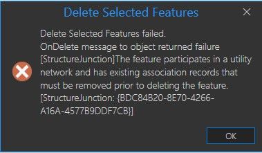

Hi,
I have defined Structure attachment rule between Structure Junction feature and Electrical Junction feature.
I created about 40,000 attachments using the Append tool. How can I remove these attachments from data in bulk.

You can delete associations via Arcade e.g. https://community.esri.com/t5/arcgis-utility-network-questions/create-an-attribute-rule-to-delete-th...
Could you combine this with a batch calculation attribute rule?
