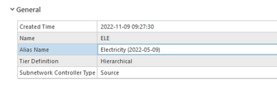

I assigned the circuit breaker and transformers as subnetwork controllers (Only from one station for the test). The features returning after the trace is too many than expected. Then, I found out that my tier definition is hierarchical and not partitioned. I received this tier definition after I converted the asset package to UN.

1) Does this tier defition affect the trace pattern in UN? (I think so but I am not sure)
2) If it affects, then how can I change back to partitioned tier definiton? (As for electricity I think it should be partitioned) Is it possible in ArcGIS Pro or should I change the asset package during the migration?

Hi Acharya;
It's hard to guess the specific issue going on without looking at your network configuration.  Unfortunately, once a tier is configured as Hierarchial, it can't be changed to a partitioned tier.   I would strongly reach out to Esri Support and let them take a look at whats going on with your prototype.
