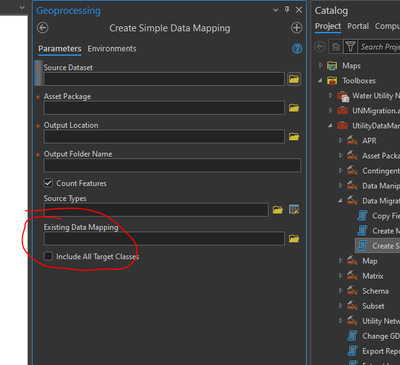

Can these sheets be manually added and populated with stormwater related information (assuming we can figure out that information)?  Or do we move along with the current SW DataMapping.xls table with the existing worksheets?
 - Unless you need them, should not affect anything
- You can run the Create Simple Data Mapping and include the old sheet to carry it forward into the new schema
