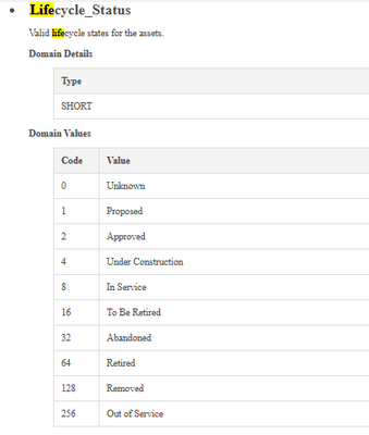

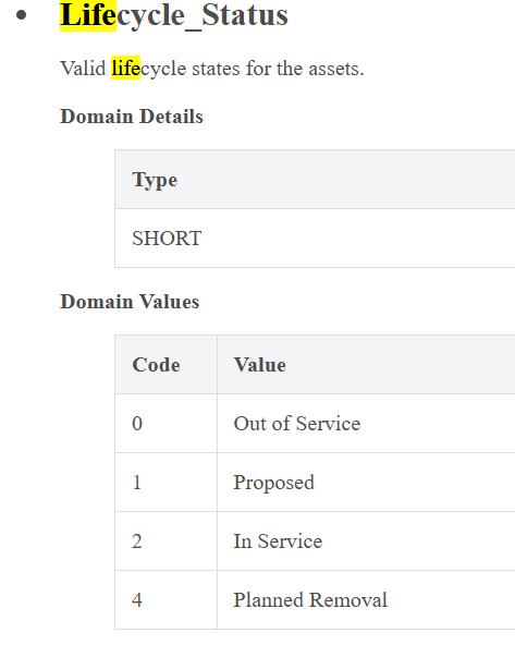

@RobertKrisher Can you confirm if the data dictionary listed on solutions.arcgis.com at this link electric foundation Data Dictionary is up to date? It appears to be several versions old. We have a copy of a different version v5.1 of the electric foundations data dictionary that has several major differences, especially the domain for lifecyclestatus that is significantly shortened to only contain 4 values. Is the shorter domain a more recent change by Esri, perhaps to improve subnetwork performance? I am trying to get a sense of which foundations data model is the 'latest and greatest'.

This is the domain for lifecyclestatus at electric foundation Data Dictionary

@MikeMillerGIS those are for the Unbalanced and Expanded data models. Can you update the foundations data dictionary here? - https://solutions.arcgis.com/electric/help/electric-utility-network-foundation/DataDictionary/DataDi...
MikeMillerGIS
Esri Frequent Contributor
The
https://doc.arcgis.com/en/arcgis-solutions/latest/reference/other/ElectricExpanded_DataDictionary.ht...
 replaces the link you provided.  That link is for the older version of the solution and we cannot change it due to version control
