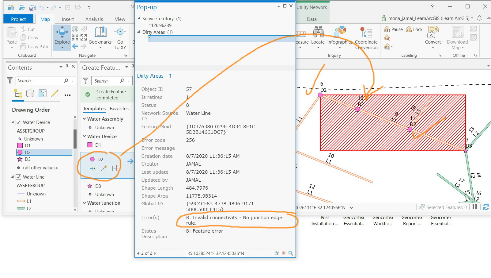

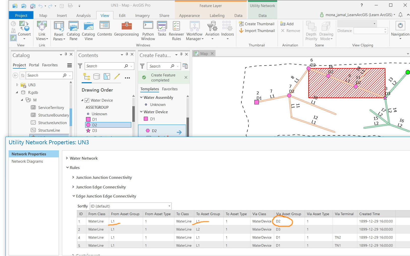

I couldn’t figure out which rule does allow connectivity between a device and edge midspan.
For example, D2 device is configured to connect between edges of L1 asset group. If it’s digitized in the midspan of L1, then an error is generated

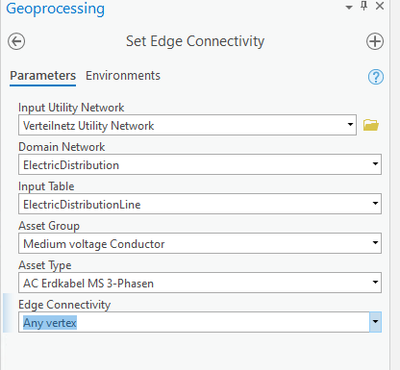

Hi Jamal,
in the tool "Set Edge Connectivity" you can change "Edge Connectivity" to 'Any vertex'.
