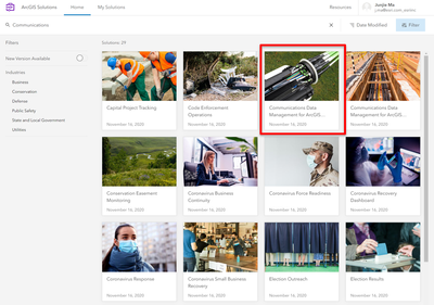

Thank you for providing the detail. Along with our communications solutions, Esri also refreshed the ArcGIS Solution Site. Here would be how I deploy and access the solution package.
Go to the link below to find the Communications Data Management for ArcGIS Enterprise, and deploy now:
https://www.arcgis.com/apps/solutions/index.html?searchTerm=Communications&sortField=modified&sortOr...

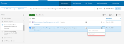

Then you can download the solution package from the ArcGIS Online folder: 
After you unzip the file, you should be able to see the complete solution folder and open up the project:

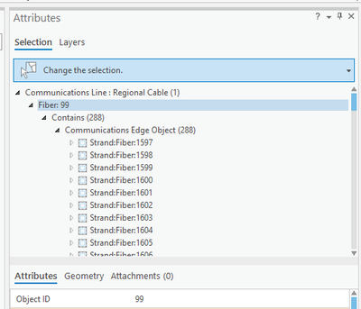

The non spatial objects are rows in the JunctionObject and EdgeObject tables.  In the comms model, you can explore these by opening the attributes of the spatial features and expanding the tree view.  The attribute dialog displays the associated features similar to related features.
Here is an example from the cable.  This cable contains strands which are in the CommunicationsEdgeObject table.
