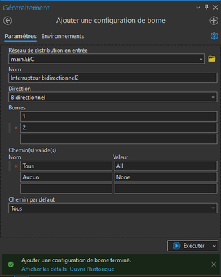

Hi,
Adding a terminal configuration works well in ArcGIS Pro interface (v3.1.2), but fails in python with the python command copied from the interface...
I think it is a translation issue (only the alias "ALL" is valid in the python command)

But I still think there is a difference between the Pro UI behavior and the code, because in the UI, you can translate the alias of the valid paths (see my 1st screenshot), what you cannot do in the code.
See the result in the UN properties :
