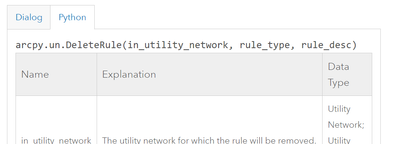

esri dociment is saying to verify the description.
https://pro.arcgis.com/en/pro-app/3.0/tool-reference/utility-networks/delete-rule.htm
RobertKrisher
The documentation says to include the rule id and the description, but as I said I don't think the tool currently verifies the description. Test it out and let me know!
