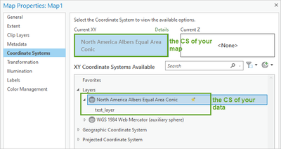

As @jcarlson said, your map frame is probably using the same coordinate system as your data. But you should probably check to make sure it is. If you are using ArcGIS Pro, you can check it here:
When you Geoprocessing tools, they will use the coordinate system of the input data to compute the analysis.
