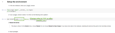

You might try upgrading the version of the Python API in the notebook to 2.0.0 (use the same procedure as in the current notebook for upgrading but specify 2.0.0 as the version number)  and training the model. If that doesn't solve the problem, the next version of the API (2.0.1) should be released soon.

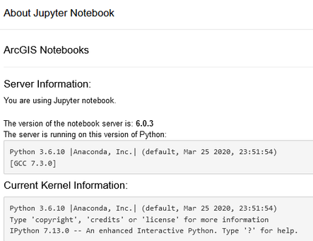

I am using Notebook in ArcGIS Online. Where can I change to Python API 2.0.1?

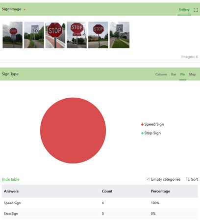

There is new beta version of app 3.15.158 available as of yesterday. I have checked out. It works with the smart camera behavior. One bug I have found so far is that stop sign images are identified as Speed Sign. I have taken 4 stop signs and they were identified as Speed sign. I am going to test out more.
Thank you for your responses!

You can upgrade the version of arcgis (the ArcGIS API for Python) in the second cell of the notebook.
Where it says:
pip install arcgis==1.8.4
change the version number from 1.8.4 to 2.0.0
After the 2.0.1 version is released, you can use the same procedure to upgrade to it.
