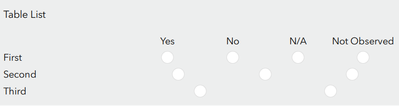

Is there any way to accomplish a compact form like a table list in which users see the available choices in the same positions, but in which the choices available can change? Simply using two or more choice lists in S123 causes errors. Here's a mock-up:
What I'd like to getWhat I'd like to get

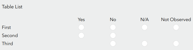

I've tried using choice filters, which do effectively limit the choices available, but the positions are not held.
The closest I can actually comeThe closest I can actually come

You can't do it with a table list, but you can mimic the effect by placing your questions in a grid and hiding the appropriate responses.
