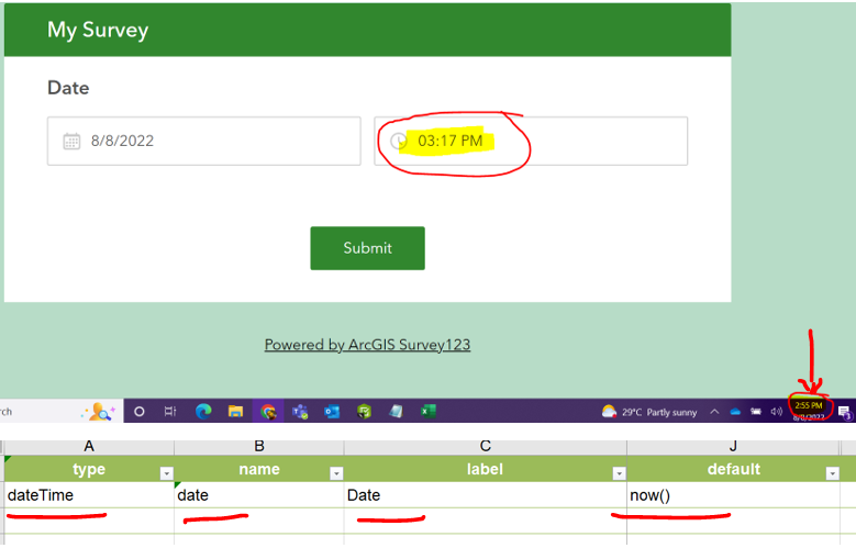

I am facing the unexpected problem on Date calculation. For the solution of date things I used the both platform Survey 123 connect (version 3.15.170) and Survey 123 Web. On the basis of survey I observed the following things:
Observation 1:
I have created and published a survey form using Survey 123 connect. I used the date time question in the form and make it default as now(). When I opened the survey in web, the time showing incorrect its almost 30 minutes ahead from the local time.

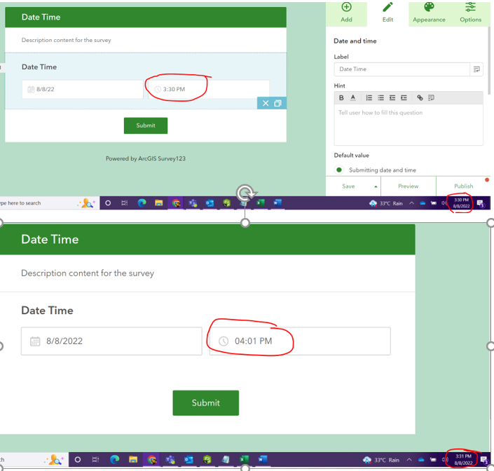

Observation 2:
I have created another form using Survey 123 web. same I used the date time question and make it default as submitting date and time. the survey time showing correct as the local time. but If I publish it, the date result shoeing incorrect same as scene 1 (time incorrect almost 30 mnts ahead from the local time)
Could you help me to resolve this problem.

Can you add the following to you survey and tell us what result is:
typenamelabelcalculationbind::esri:fieldType
calculatewsdatetimeSample Date/Timenow()null
calculatewstimeTimeformat-date(${wsdatetime},'%H:%M')text
