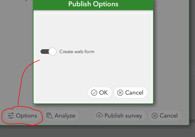

Did you make sure this is still on when Publishing?
JoseBarrios1
Hello Doug,
Yes. it is on. I just publish a very simple form to test and it works. I try several of my other forms and don't work. Not sure what it is going on!
