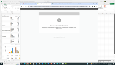

Hi, after the last update received in Survey123 connect (3.14.256), several Survey form's item details are not accessible in our organization. Please see the screenshot below.

AliSaad2
I am facing also the same issue as per the belwo screenshot. Any updates in this regard?
