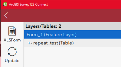

  1. Photo image caption text.  The output formatting is not great. Would be better if could combine all text onto one line. Stuck on property syntax for each image caption. The field for the photo point number is outside of the photo repeat so I’m not sure how to pull it in for the desired formatting. To pull something from outside a repeat into a repeat for a Feature Report, you need to use dot notation (disclaimer: probably not the official name). Start by going to the "Schema" tab. Look in the top left and note what your main Feature Layer is called. E.g., Here, the main layer is called "Form_1"
    Then, identify the field that is outside the repeat that you want to use. For example, l
    et's use ${photo_point_number}...
    ${#repeat_test}${Form_1.photo_point_number}${/}

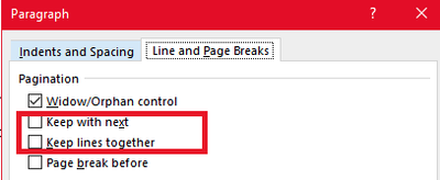

  2. Images split from image caption text . The title for the next image does not stay with image. This isn't a high priority but it'd be nice if there were a way to fix this. This is a word doc formatting thing. A few pointers:
    - Put your images/repeats into tables.
    - Try spacing and sizing items so you always have the same number of items per page (E.g., I set my pages up to accept either 2, 3, or 4 photos max per page, depending on the Feature Report). If you haven't played around with photo sizes yet, go here and look for "Images and Other Attachments".
    - Use word's built-in line break options
  3. Image size/ratio is inconsistent using take photo vs. browse options. Photo 3 was uploaded and most others were taken directly in app. I prefer the size/ratio of the photo that was uploaded rather than those taken within the app (only testing in Survy123 app because this is how data will be collected) See above. Not much you can do for ratio though.
