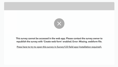

Hi, after the last update received in Survey123 connect (3.14.256), several Survey form's item details are not accessible in our organization. Please see the screenshot below.

Same issue here. Republishing the surveys does not help. Console shows CORS errors, but there is nothing that has changed on our Portal end in the last 24 hours.
Also, when trying to access the item directly from Portal rather than the Survey123 site, we get a slightly different error, stating the .webform file is missing.

Some more insight into our issue. As others have mentioned, the console shows a CORS error but our CORS settings are completely open. Also if you watch the network traffic while attempting to open a survey detail page, you can see many successful requests and a single failed request. CORS issues wouldn't allow some requests to succeed and others fail in this manner.
I dug into the failed request. It's the `/search` endpoint searching for the ArcGIS Online Vector Basemap group, as its url exists via our Portal:
