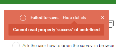

So on the public survey link, it looks like this:
And on the "Share Survey" tab on "Collaborators" on Survey123 online it looks like this:
 This error message comes up whenever I try and share the survey publicly.
