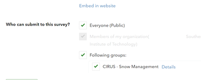

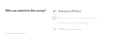

I can not find a help document for this error. This is from a survey on the web and it does not have an error if I open it while signed in to AGOL. But, when anyone else opens it they can not submit a survey. It is a public survey.

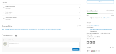

The form is shared publicly. When I submit a Complaints Form survey it is added to the Complaints Form feature layer. So, the feature service exists, but it's not shared publicly. How is it not accessible, as the error suggests?

@Anonymous User I agree with your comments, it sounds as if someone else or an administrator has changed some of the sharing settings or permissions of the underlying feature service, form item or related views. If those changes are made in the AGO UI or another Esri app, it will cause the checkboxes in the Survey123 website to be differnet the next time the site is refreshed, as it reads them from the source items.

Not sure about your first question because I have an administrative role in AGOL. For that matter, it could have been me. As Phillip was saying, I was actually changing the sharing settings in the hosted feature layer when I was trying to correct the error. So, maybe it was me who reset the check boxes? Thanks for making me aware.
